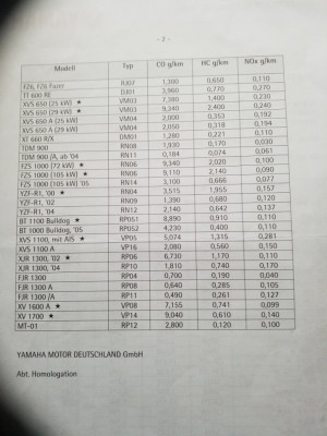

now i have a question ...
is the warrior [mine is 2003] euro 3 emissions standard ...at present here the government does not know, and assumes its like a car, and charges £12.50 per day to ride into the london area !! which is all the way out to the motorway 25 [m25]
but if we can prove it is below CO 2.30 g/km then we can ride in for free
i found a midnight 2009 for sale here that said it was CO 1.39 g/km
i will then need to find a certificate maybe from yamaha that says that
can anyone help please?

jungs, hat von euch vielleicht noch einer n tüv bericht rumliegen? da is der wert ja getestet. vielleicht könnte das ja helfen. ich guck morgen mal ob ich noch einen rumfliegen hab

Hi Tomba,
Hope this one helps, as it does list XV 1700 VP14.

thank you thank you
it turns out after much investigation that it is the Nox that is most important ... set at max 0.15g/km as per euro 3 emissions standard
ill have a look at your reports ...

So should turn out well for you ? 0.14 if I read correctly.
Re: tomba suddenly appears!
we will use your report to ask yamaha for a certificate of conformity ... fingerscrossed
